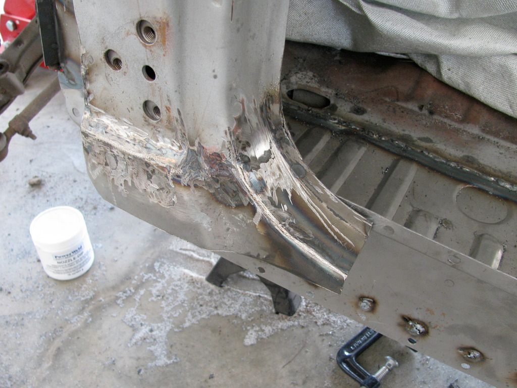

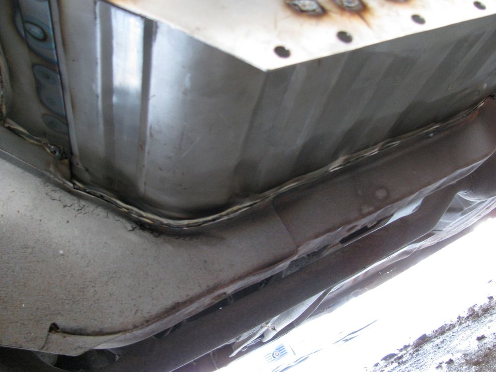

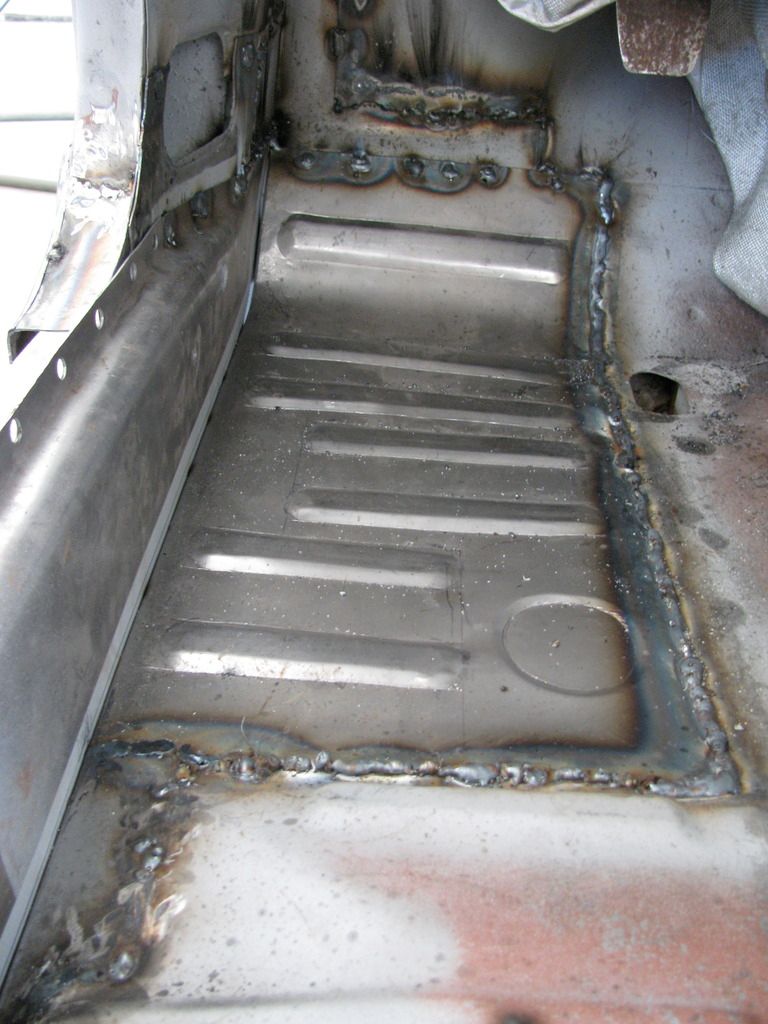

white_cross Posted July 21, 2016 Author Posted July 21, 2016 I finished welding in the driver side front floor today. I am very happy with how it turned out:
Jim Eh. Posted July 21, 2016 Posted July 21, 2016 Remember you don't have to be a good welder .... just a good grinder. j/k looks excellent.
white_cross Posted July 21, 2016 Author Posted July 21, 2016 5 hours ago, krank said: Remember you don't have to be a good welder .... just a good grinder. j/k looks excellent. Thats me for sure! I have not welded since high school (like 15 years ago) and this is my first time ever welding on a car. I just went for it and hoped for the best

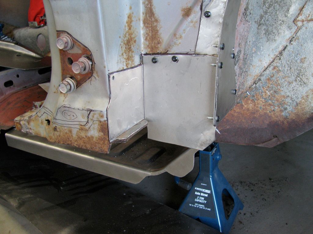

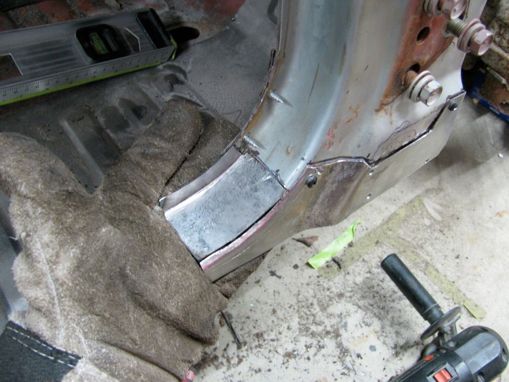

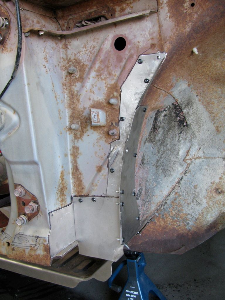

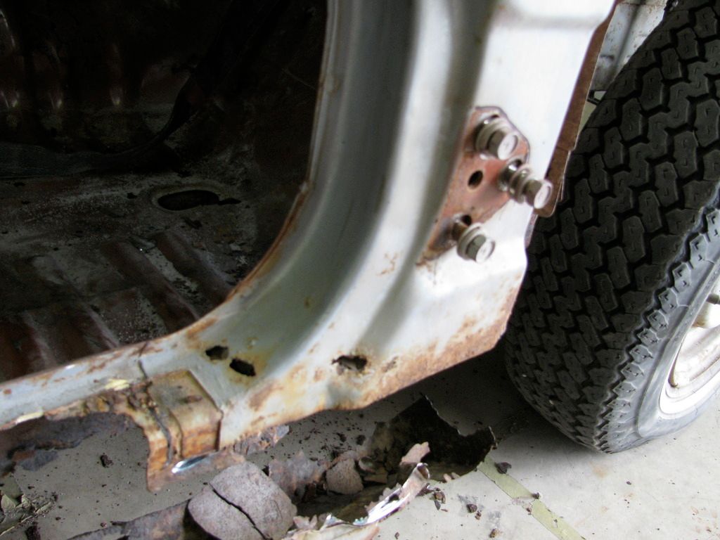

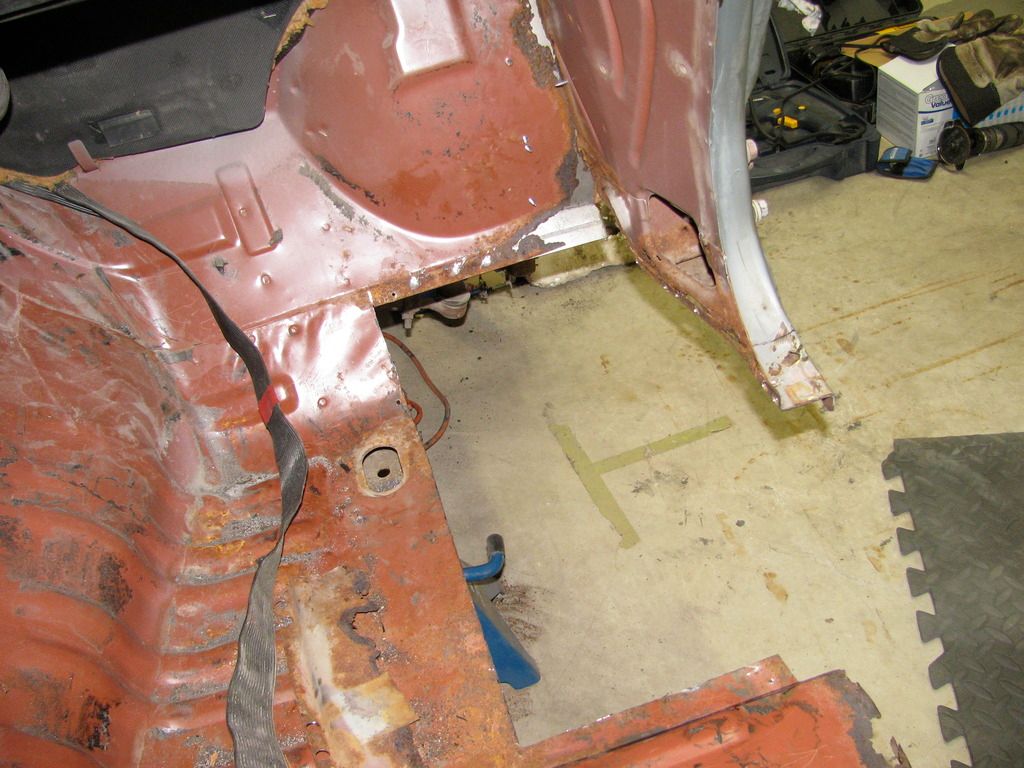

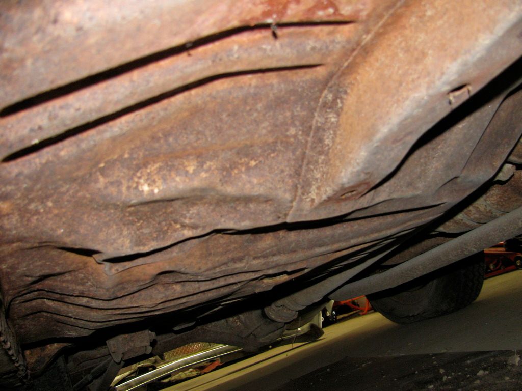

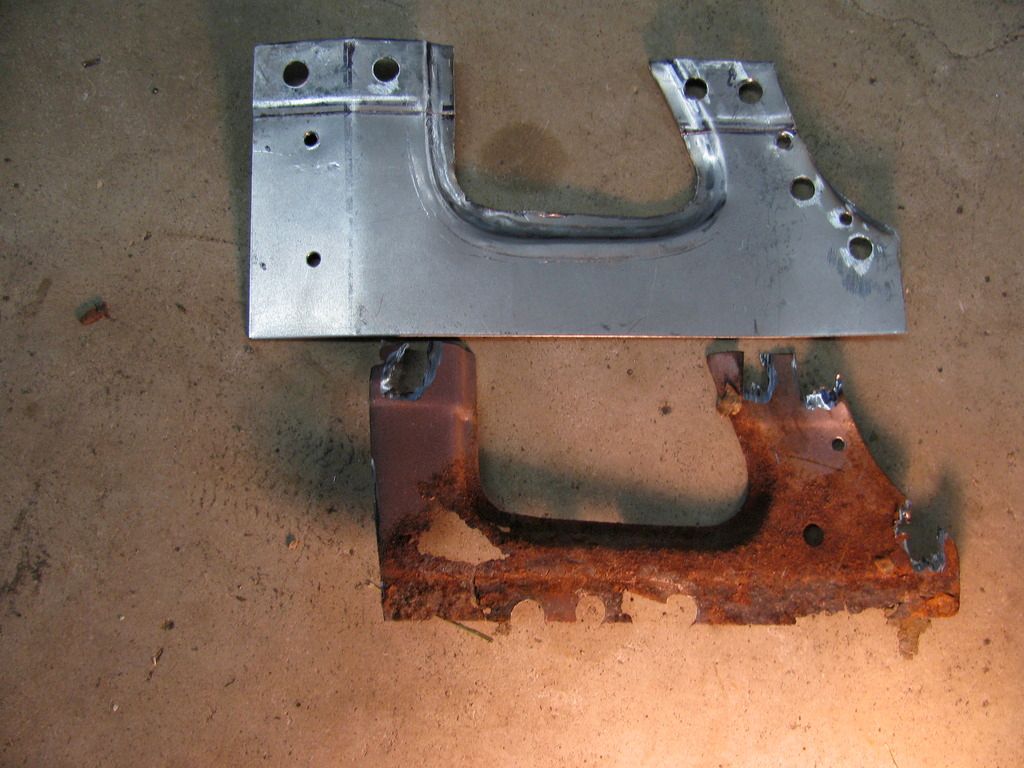

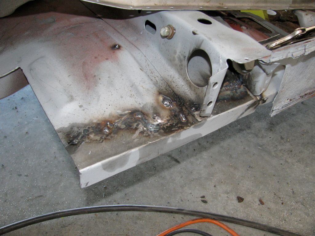

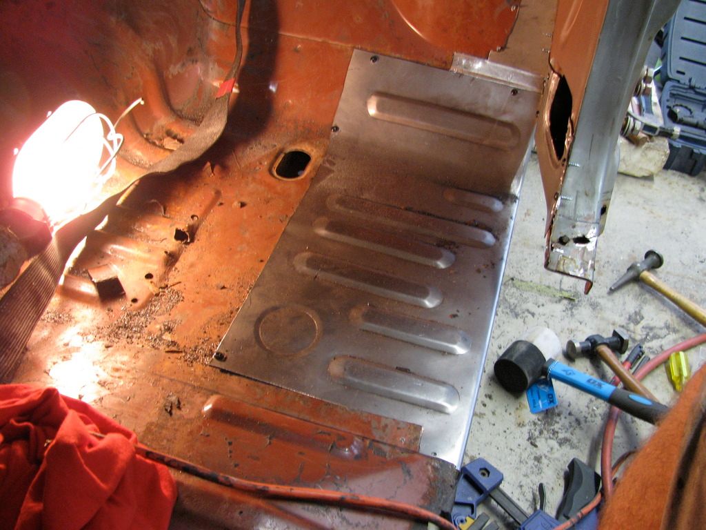

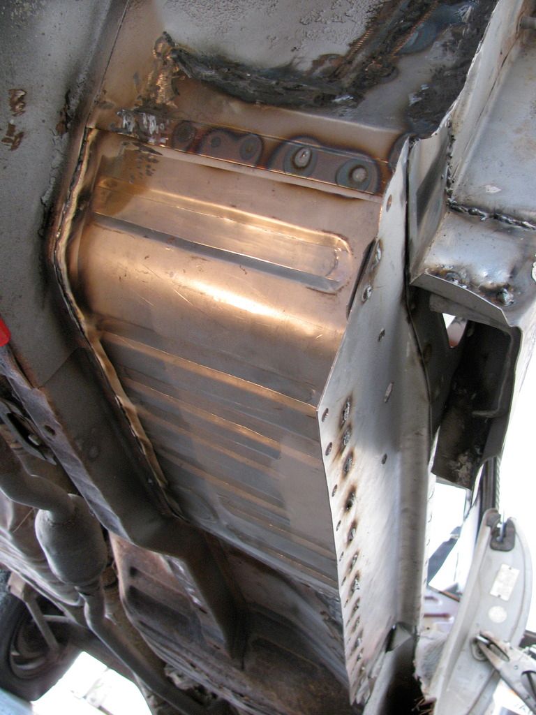

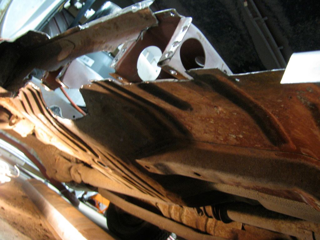

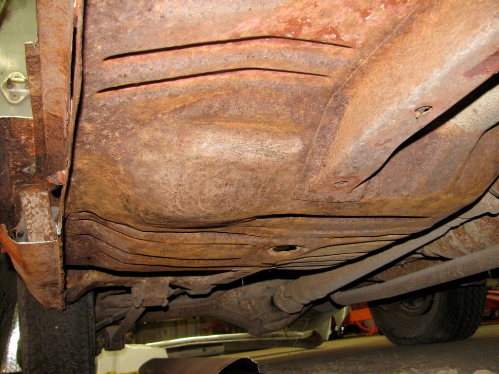

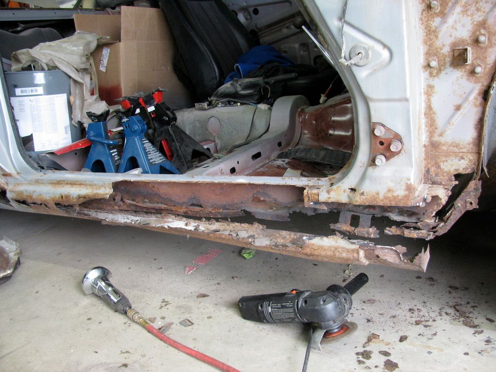

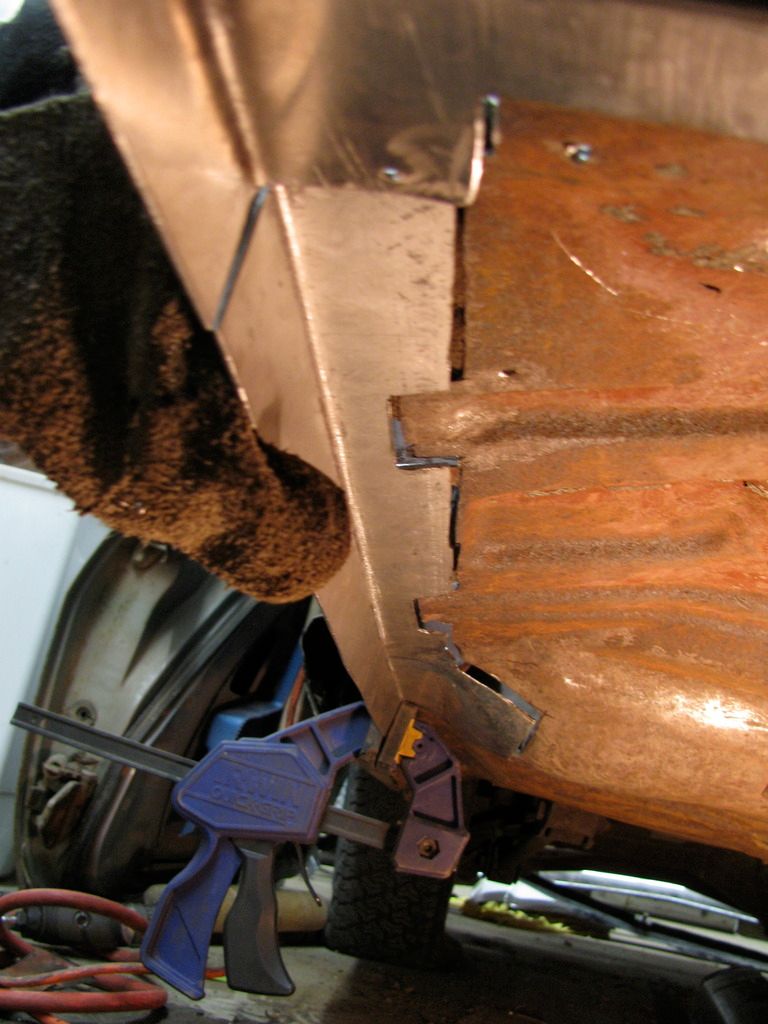

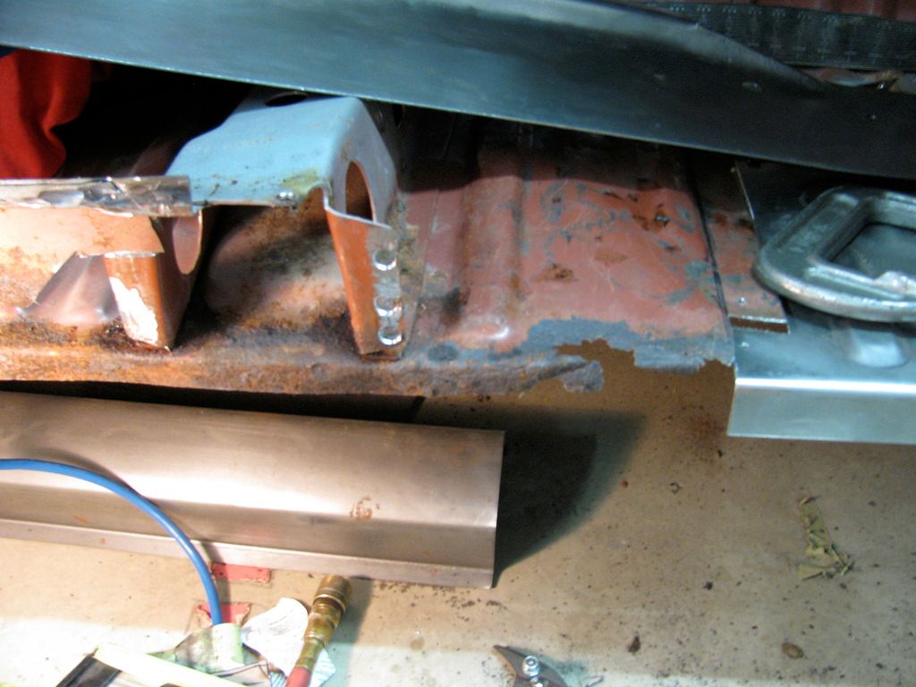

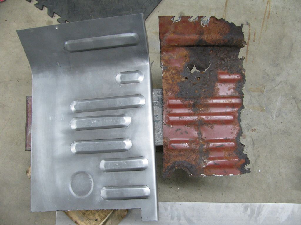

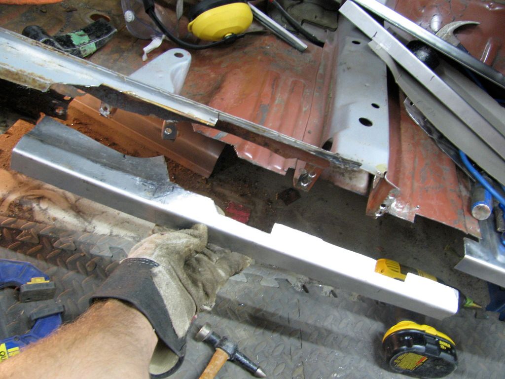

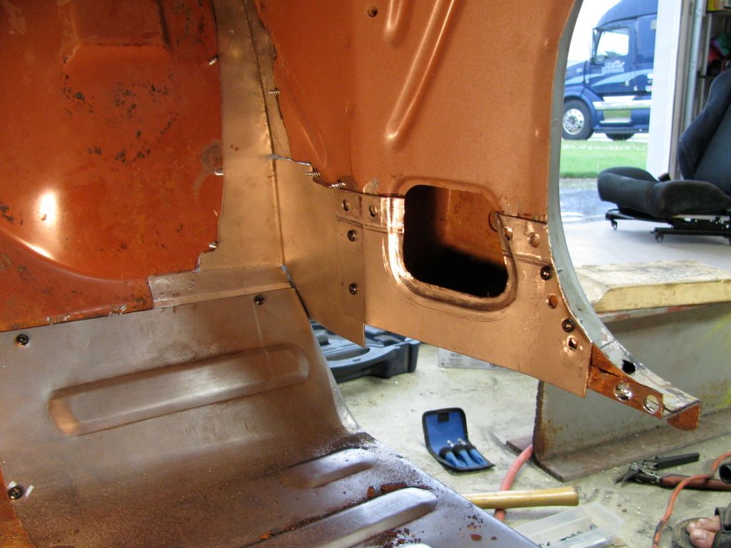

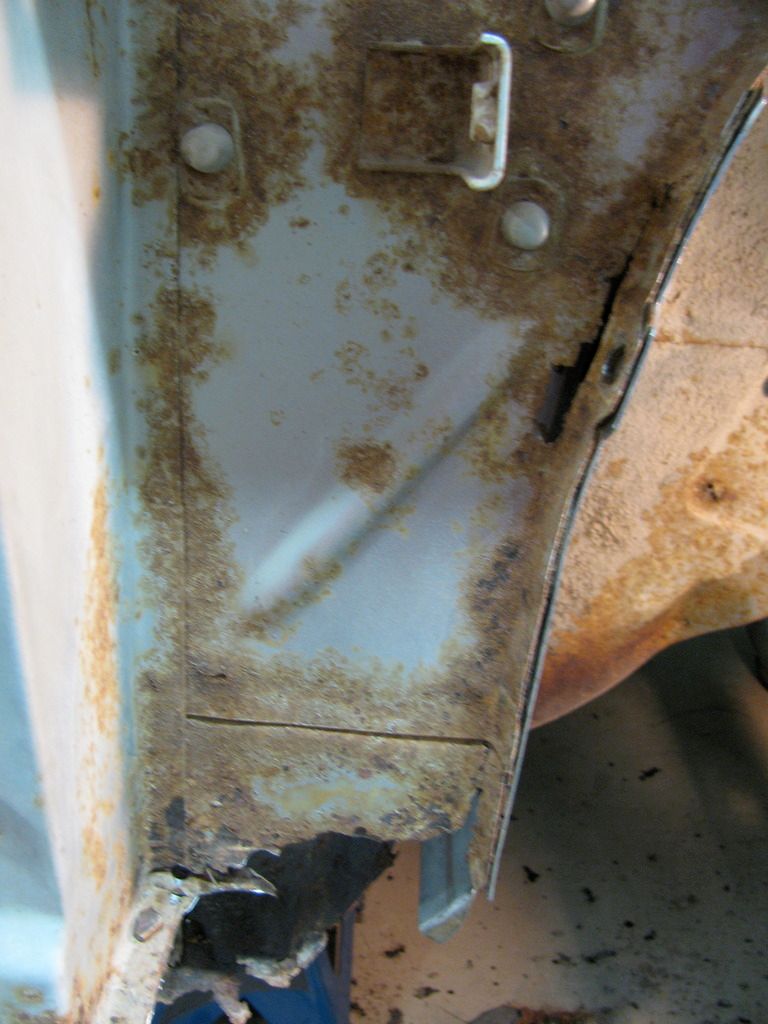

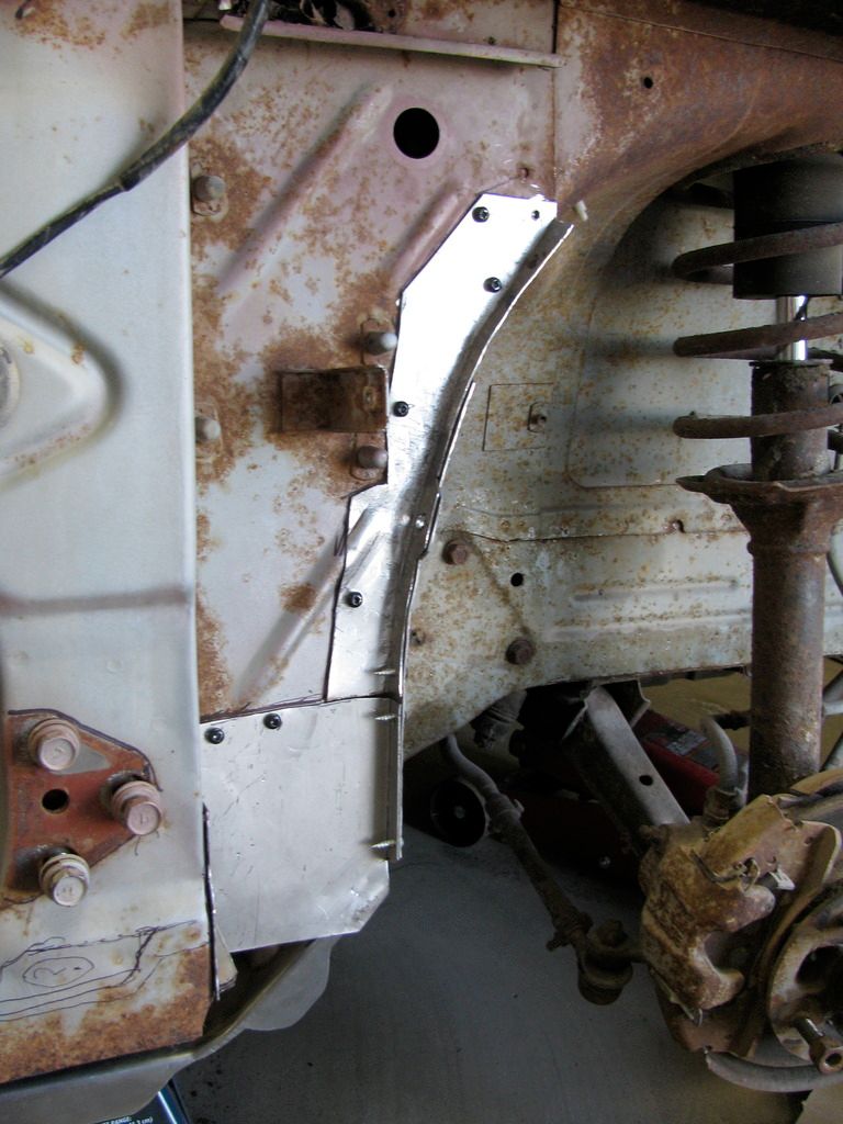

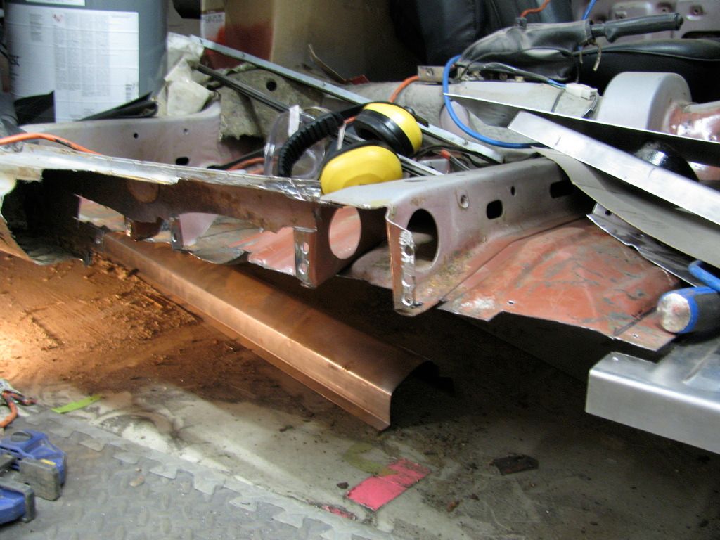

white_cross Posted August 10, 2016 Author Posted August 10, 2016 TIme to do something about the passenger side. It goes so much smoother once you have done it once. Here is what I get to start with: The front fire wall corner: The lower dog leg to fire wall cut out and new piece fabricated: Old floor pan cut out and new one test fitted: new inner dog leg: outer dog leg: The passenger side rear floor pan foot section of floor was completely crumpled from either jumping the car in its past or falling off the jack stands. I hammered an dollied it back to shape: before: After: And the final piece of this puzzle the 90 degree edge of the floor pan that goes under the floor pan and the rear seat brace:
