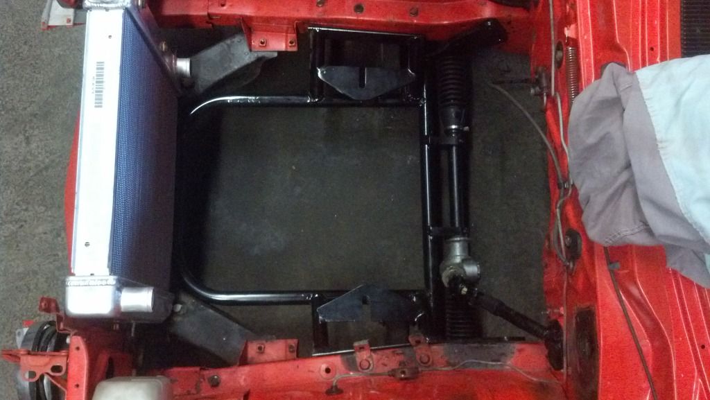

white_cross Posted June 22, 2015 Author Posted June 22, 2015 I just came across this while researching engine swaps for these cars: http://1stgencelica.com/viewtopic.php?f=15&t=17982. The guy builds cross members and transmission mounts for engine swapped 1st gen Celicas. So When I finally decide on an engine This should make things a lot easier.
MRS Joe Posted June 22, 2015 Posted June 22, 2015 I just came across this while researching engine swaps for these cars: http://1stgencelica.com/viewtopic.php?f=15&t=17982. The guy builds cross members and transmission mounts for engine swapped 1st gen Celicas. So When I finally decide on an engine This should make things a lot easier.Need to be registered to view link.
white_cross Posted June 23, 2015 Author Posted June 23, 2015 I just came across this while researching engine swaps for these cars: http://1stgencelica.com/viewtopic.php?f=15&t=17982. The guy builds cross members and transmission mounts for engine swapped 1st gen Celicas. So When I finally decide on an engine This should make things a lot easier.Need to be registered to view link. Sorry I forgot about that, here is a quick write up from one of his posts: This is a custom Cross member "Cradle" setup I have created and build in house. It allows many engine swap options thats just not possible with the stock forward swept cross members the 71-75 Celicas have. Also Carinas. I have a couple of different Jigs setup and if local I can setup any engine almost in your car for extra. 2/3RZ and 18r I have. I have one offed a 1UZ and a 1/2JZ and a one off 3STGTE others have taken a bare Cradle and custom there own engine mounts.These use several mounting locations including the stock steering box and idler arm locations plus 2 locations per side spread out to stabilize the cradle so a simple road hazard does not bend your cross member. This method allows for a stronger setup and stabilizes the lower control arms and the steering rack plus gives you a higher ground clearance to avoid those small road hazards. I also have a front mount bar to allow even more support for those high HP swaps like the LSX engine swap a buddy is using one of these for.The Rack conversion uses a 83-84 manual Rack and the steering column needs to have the lower section changed out to a lower U-jointed shaft. I can help with this as well. I will need your column mailed to me and I will mail it back to you completed for 200.00 and I will supply the needed parts.I also make a tranny cross member that's cleaner than stock and will allow more room for exhaust to get over rather than under the stock cross members. It will also fit the later model trannys with out hanging off the last bolts or require something funky. These sell for 200.00 shipped.Cradle cross member goes for 700.00 plus shipping with the Jigs I have and up from these if I have to custom something for you. Shipping sucks just to warn you.I can do a blank cradle with no engine mounts for 650.00.I also make a Rack conversion bracket that requires no cutting or welding. Its a base of the Cradle or the Cradle is an extension of this actually. These mount to the steering and idler mounting locations and the lower control arm mounts. These wont interfere with the oil pan but you will need to modify or remove the lower block to the tranny supports and the exhaust down pipe as well. The steering shaft will conflict with the exhaust. The steering column will need the same modifications that's the Cradle requires. These sell for 300.00 shipped.
